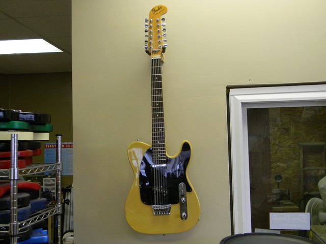

THIS looks like something RobOG made. It's even in Wisconsin. Look at the stack of Strat bodies. I smell GFS.
Yell Like Hell
Mo Law-ka
strictly roots
Posts: 3105
Location: a series of tubes
Post by Mo Law-ka »
It looks like they put a new fingerboard on it. The Villager had a heel and fretboard end which curved with the soundhole.

There was a reissue a couple of years ago with a "normal" fretboard heel -
robert(original)
Posts: 7174
Post by robert(original) »
they probly sanded it flush. the truss rod is recessed enough to do that. and you can always remove the nut but to get more space to do so.

Matthew, the newer reissue has a set neck, compared with the older Villager model that was a bolt-on.

Mo Rawka wrote:Matthew, the newer reissue has a set neck, compared with the older Villager model that was a bolt-on.
Uh huh, I kind of figured Fender had been quite badly burned by the bolt-on acoustic reputation after I posted the pic.

the body rod is actually an old selmer mackaferie design from.... god, a long ass fucking time ago. i assume that image was from a newporter or kingman. i had a newporter neck and i was supprised to find that the heal was rather narrow, like, by a good 2mms or more at the 12th and it carried thru the rest of the way. i know i made a neck template of the neck i had.
that seems to be an untapped market, buy a newporter neck for less than 50 bucks, sell the tuners for 60 bucks. buy some nice re-issue tuners for about 20-30 bucks. walla, vintage fender neck with nicer tuners. but like i said the heal is different.

How weird - would have thought a wider heel for an acoustic neck. That pic was a 68 Palomino by the way, apparently.

I saw this the other day. I want that neck to make an electric xii

in reality its not hard to take one of those necks and throw it onto an electric. just make a bigger than needed neck pocket, and make the guard to fit the shape of the neck and you are in business. in reality i want to say that i made a tele style neck pocket and then just drilled two holes on either side of the butt end of the neck pocket and the neck slipped in and was snug as a bug in a rug. obviously it didn't fit like a strat,tele, neck pocket, but it was close enough, or as close as you can expect to get it with a hand held roughter.
