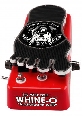

Quite a few of the Snarling Dogs wah-style pedals have 2 footswitches plus a BIG WACKY FOOT! Maybe you could a broken one, otherwise they'd be a lil too pricey, I feel:
