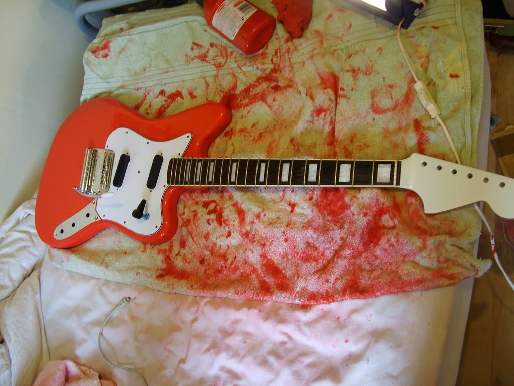

I've been buffing and polishing the guitar today. it is hard work, however the tcut colourfast is awesome stuff but you neeed the elbow grease.
Some pics, I still have to do the sides.
I like the white headstock with the red body, this is the first time I have put them together. looks kool I think. the fiesta red is weird how it changes in the light, from really salmony pink to a deeper candy red. pleased, but more work to do on the sides hands hurt and my room looks like I killed a bunch of people.

I didn't realise that buffing would be a messy process.
euan
euan
partynerd!
Posts: 27589
Post by euan »
Or am I being a spazz and the cutting compound is red itself?
I realised you used clear so there should be no redness coming off.

euan wrote:Or am I being a spazz and the cutting compound is red itself?
yeah tcut colour fast comes in different colours for different finishes.

Where did you get that neck? Offset forum?
Hurb
Peanut the Kidnapper
Posts: 7203
Post by Hurb »
More Cowbell wrote:Where did you get that neck? Offset forum?
Nah I bought it on ebay a few years ago, Its a cij jaguar neck.

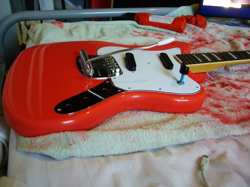

Really like the colour Hurb, that's coming out great.
Hurb
Posts: 7203
Post by Hurb »
lamp wrote:Really like the colour Hurb, that's coming out great.

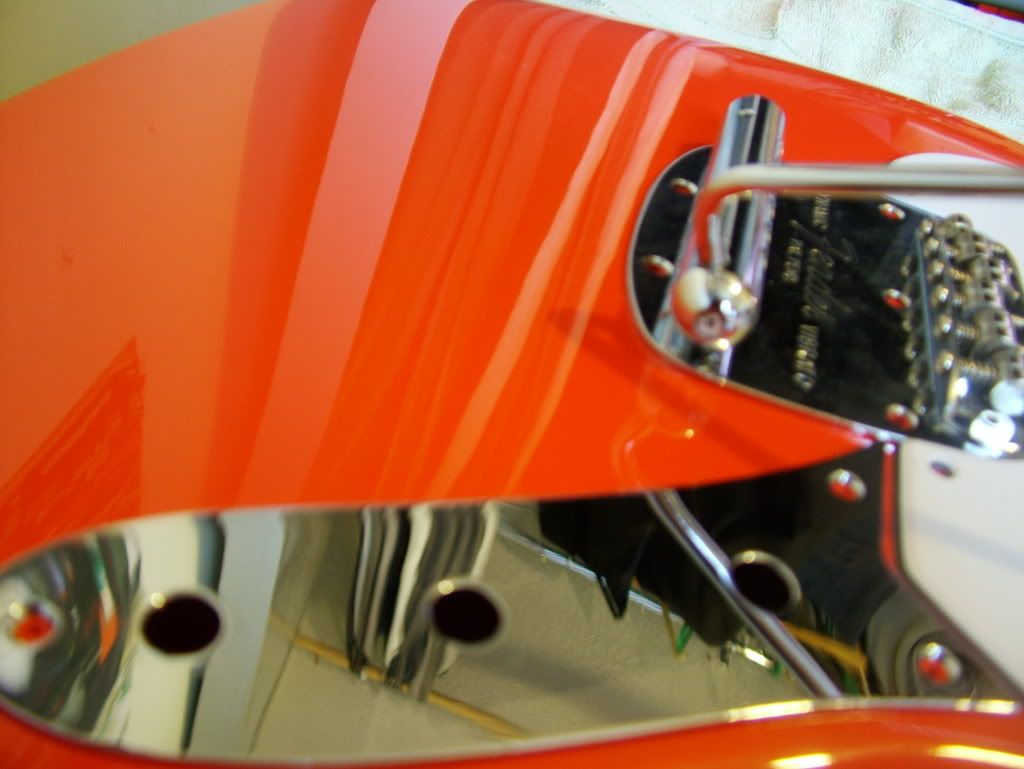

Cheers mate! I am really happy with the finish this time, It's my best attempt yet.
The whole body is now polished to a standard I can be proud of I think. gonna rest some then tackle the headstock.

why is the switch so high?
looks good, can't wait to see it finished
finboy wrote:why is the switch so high?
It's a plastic shaft. He'll cut it shorter when the guitar is done
Zachtly.
I am waiting on a few bits and bobs before I can do the wiring up. but once its all here it should be pretty fast.
