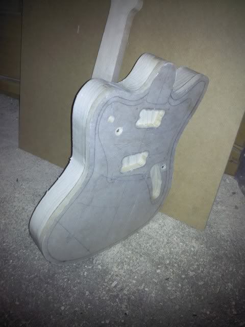

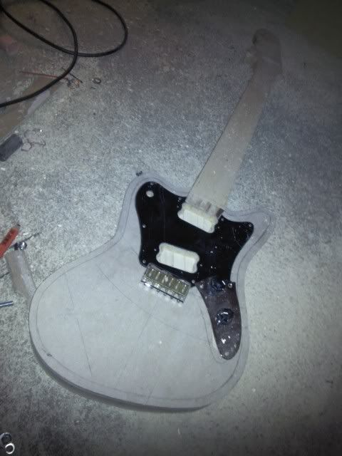

Post by wantsasupersonic »

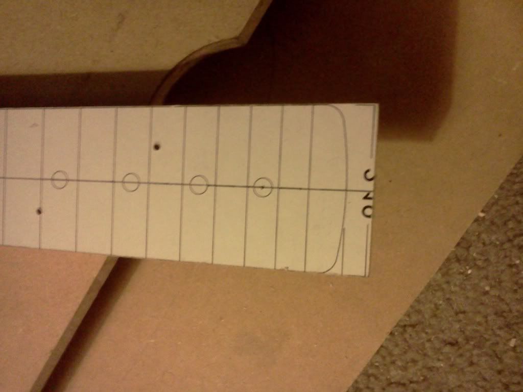

after scoring a replacement pg on the bay, and a control plate from wadeaminute. printed off the hypersonic template pdf from Wemmert. the pdf was off a bit in quire a few places, so I used bigprint and photo shop and the best pic I could find on google. I had to skew the pic in photo shop. then use bigprint to scale it properly. after that I printed it out and used sprat adhesive to mount it to mdf.
its late, post more tomorrow. about to fall asleep.
Another project I scrapped i user poly flake in the clear just to show what the finish will look like.

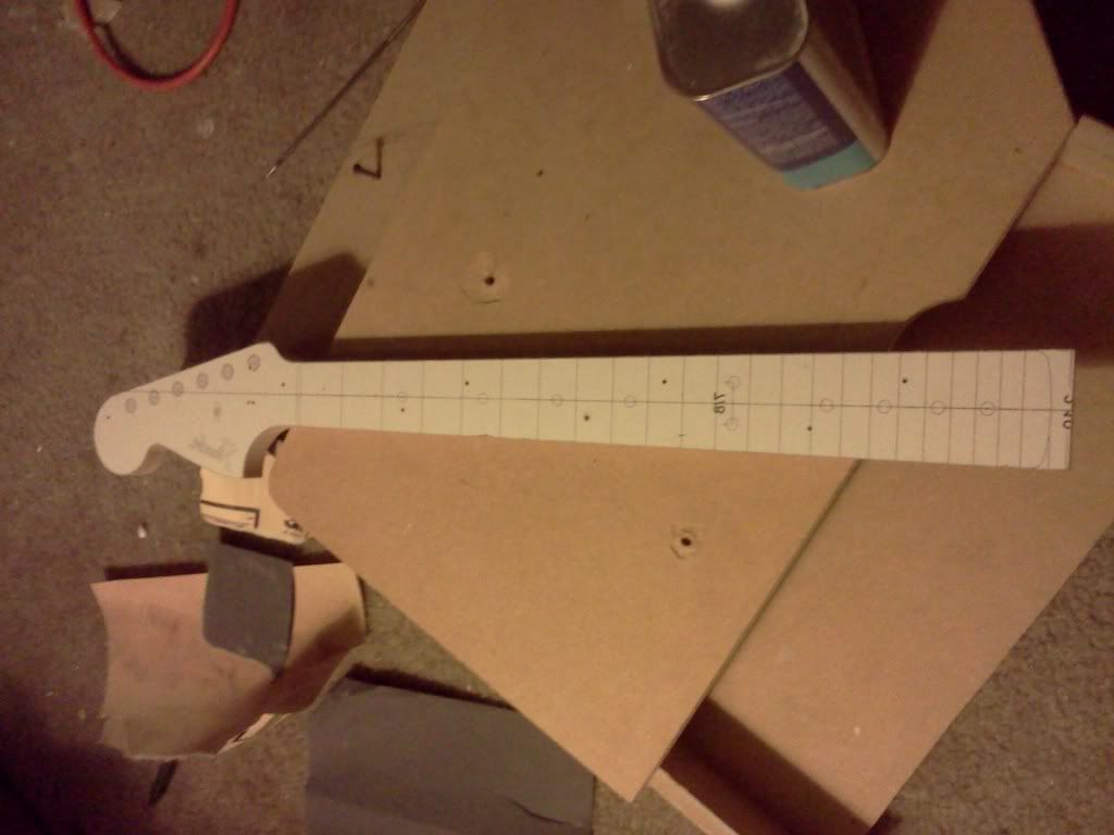

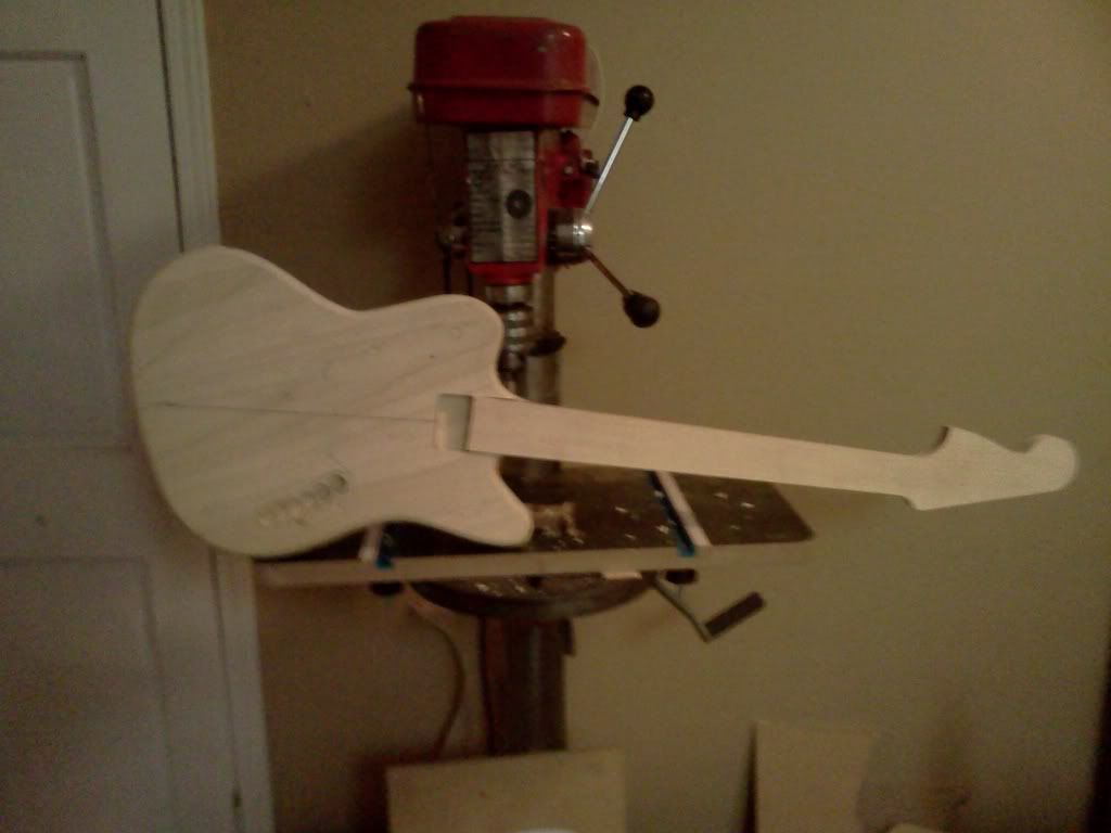

Mine will look very similar to that. so far all I've shown is the template for the whole neck length. I made another shorter neck template for the finger board. It will also extend into the maple a little just like the pic. Just enough to fit under the p/g. the maple does extend to the neck pickup when set at the proper 24'' scale. it's basically a Jag neck with the a 1/2'' added at the end. I was just going to get there but anyway like this.
I don't have a pic yet of the template heel and radius that will mach up to the pickguaed.

BTW, I had fedex reverse the pdf of the neck, because I do want the reverse headstock. Its also a 5/8''neck pocket depth just like almost all fenders, also the same depth as the pickup cavity route. the control route is much deeper to fit two 500k push pulls.

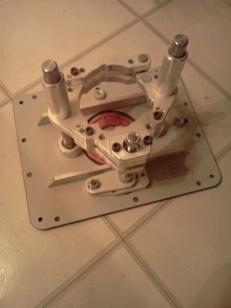

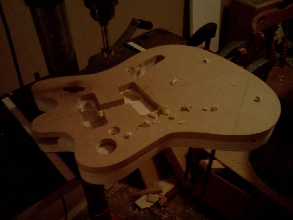

Had to pickup some new toys and build myself a better router table. one that i could quickly adjust the bit height.
Ill get more shots of the full setup later today.
wantsasupersonic
Posts: 99
Joined: Sat Jul 24, 2010 5:37 am
Location: Oklahoma

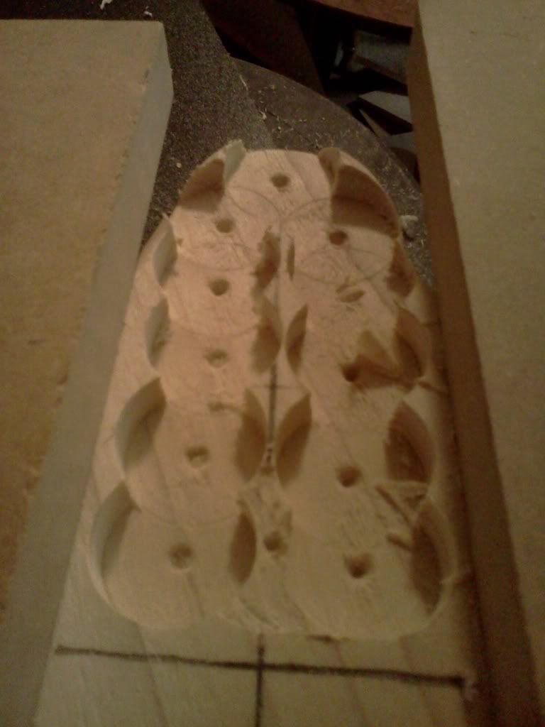

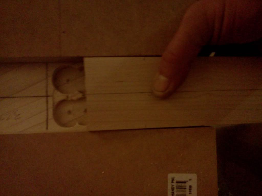

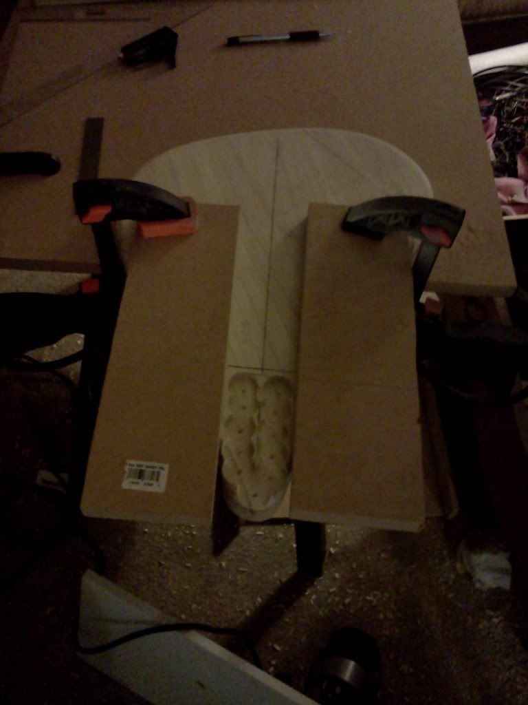

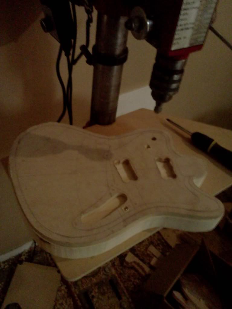

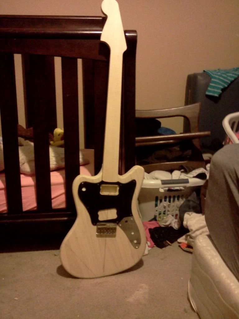

as soon as i started to route the body I really effed up. I forgot to tighten the bearing stop and the bearing dropped causing this, right next to the second pot I have a problem to solve. I'll show that later.
I used cereal box cardboard to widen the neck pocket because poly flake finishes are pretty thick.

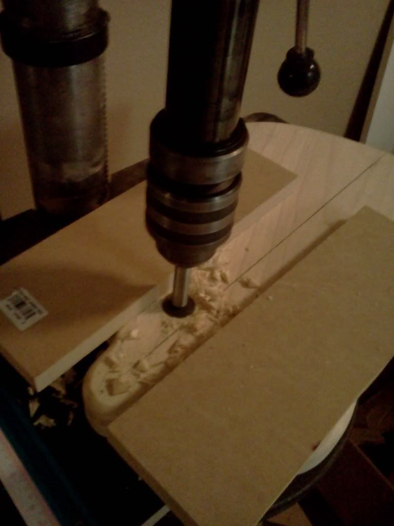

forsner bu=its make routing neck, pickup, and control cavities a lot less work and save your bits. fyi, if you didn't already know.
Just a couple quick mock ups
