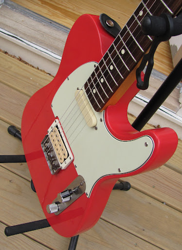

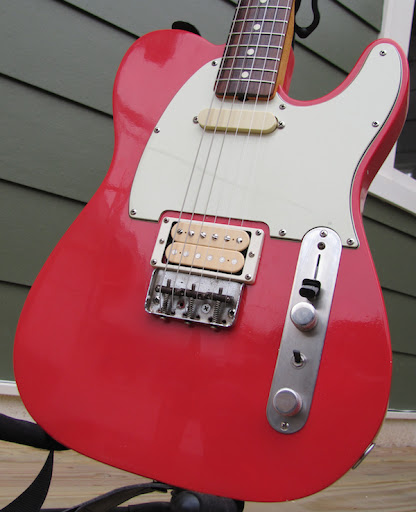

by Mages
more:
there's already nicks and scrapes. it will relic on it's own soon enough. these pictures are lying though, the finish doesn't look that good in person. here's a less flattering shot:
eh, oh well, it looks alright most of the time. lessens learned: the primer coat has to be really smooth, if not you won't be able to sand the next coat smooth because you'll just sand out the bumps in the primer. also, if you are not showing the grain,
do not sand with the grain. all it does is deepen the grain lines.

by Mages
thanks guys!
the only things I bought for this project was the pickup and the paint. I had the neck pickup, it's from scandoslav's CV duo (thanks dude!). the bridge was cut with a hack saw and the edges and corners smoothed the a grinding wheel. for the pickguard I spent half the day saturday mounting the router to a piece of plywood that I then nailed to two saw horses as a makeshift table router. of course then it only took 2 seconds to cut the guard. all the electronics was crap I already had. I replaced the screws with some shiny ones that I had. otherwise it is a joe strummer tele. =]
