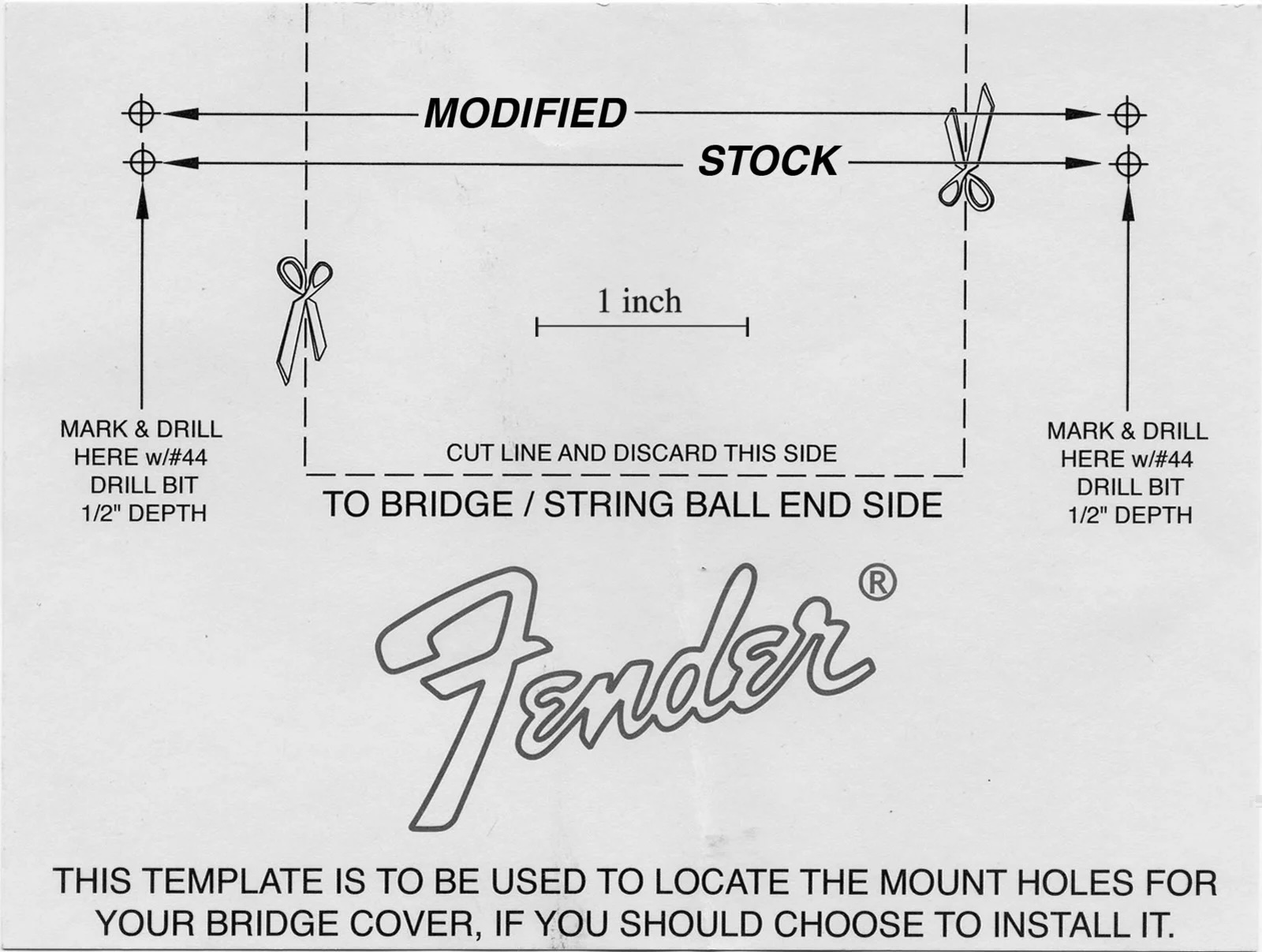

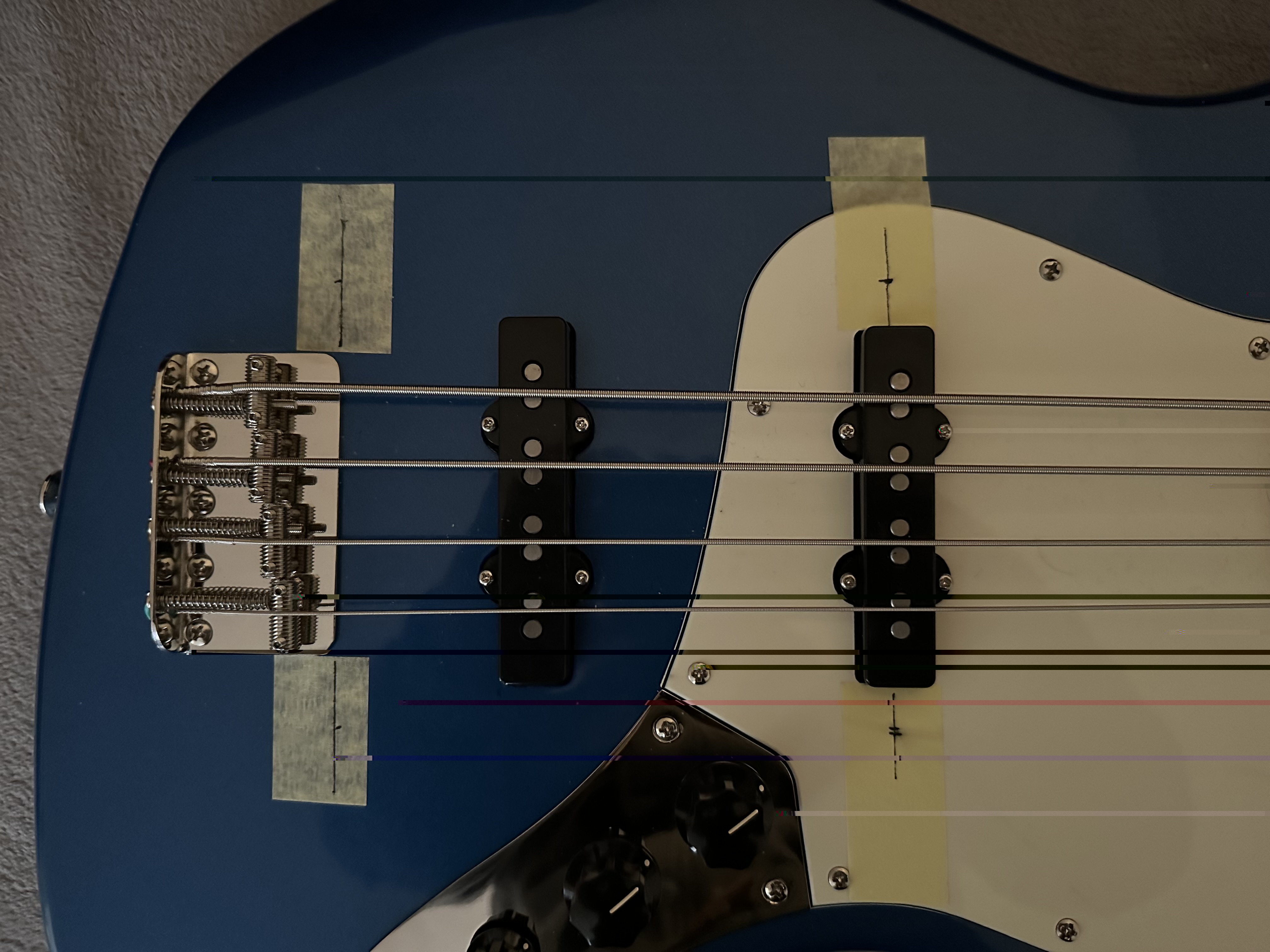

That's me all lined up for some hardcore drilling action. Used the below guide for the bridge and went with some back of a fag packet calculations for the bridge cover. I've put a layer of masking tape on the underside of the parts of the covers that touch the guitar as well, in order to protect the finish and also just to lift them a wee bitty further off the strings. The pickup cover may need even more shim height, if I test the height by boinging the strings, the low E sometimes hits the cover.
I went with the stock position for the bridge cover. So that the pickup is just peeking out.

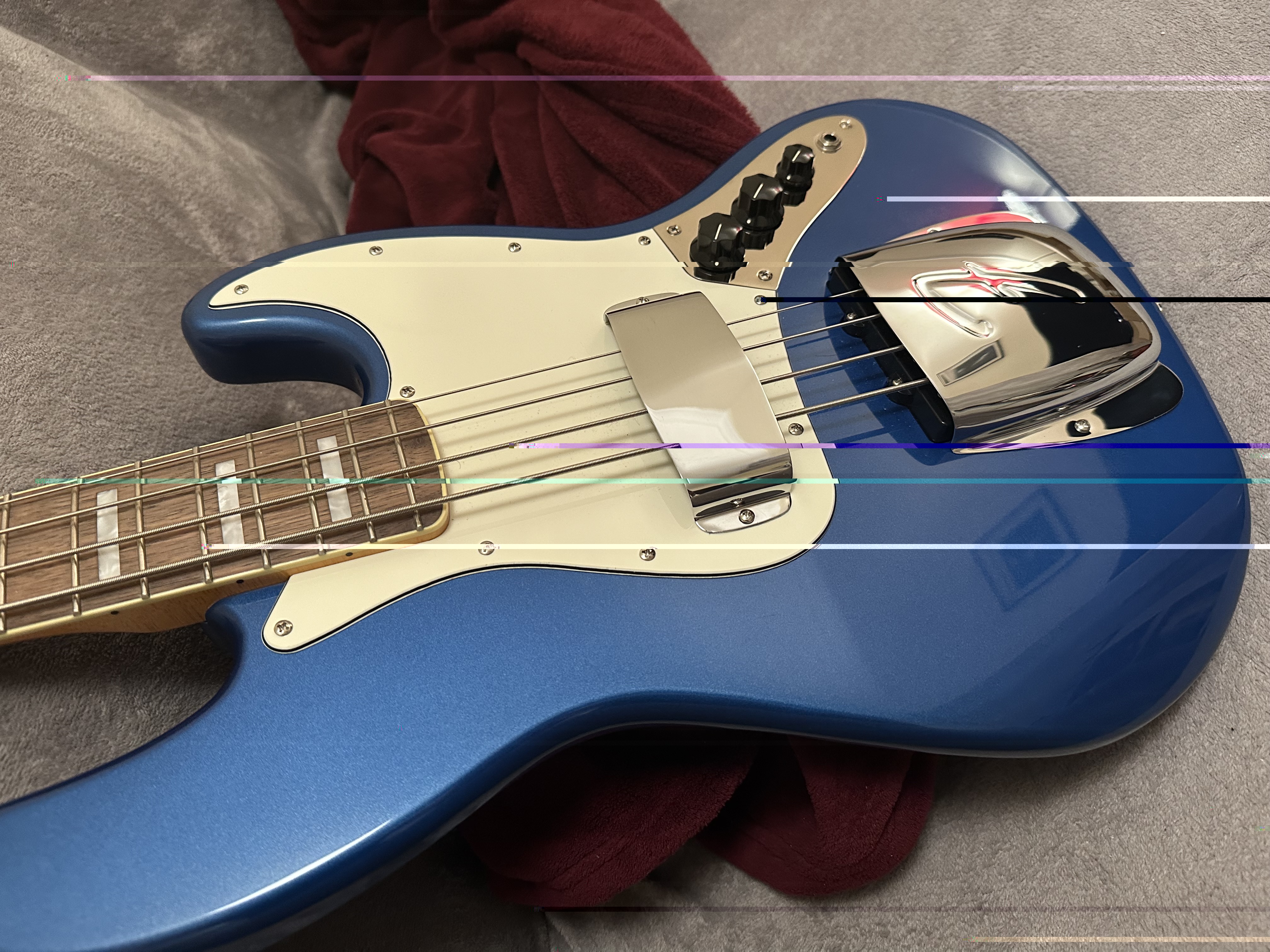

Looks great. The only surprise was when I realised that the treble side screw on the pickup cover is going into a cavity, so it's just screwed into the pick guard. I shit maself for a wee second cause I thought I'd somehow drilled right through the body.
I've been contemplating staining the Indian Laurel darker, but I feel like that could go permanently wrong and look terrible. Will add lemon oil, maybe tomorrow if I can be arsed.

I'm a big fan of the pickup cover look too - SX Vintage Series:
Re: SQUIER FSR CV LATE '60S JAZZ BASS MODS
Posted: Sat Dec 16, 2023 9:54 pm
Aw, yeah. That looks lovely. I doubt I’ll bother with the tumbrest/tug bar.
Posted: Sat Dec 16, 2023 10:15 pm
by MattK
Ain't never used it but it don't get in the way.
That laurel will probably look beautiful with a bit of oil - altho of the three laurel boards I have, one drank like a fish and sucked it down until it looked like rosewood, one was almost unaffected and one was in between.
