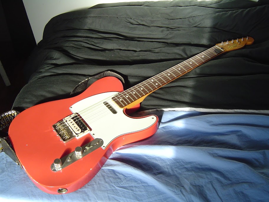

latest update: the bluesbucker... yeah... not liking it. it's actually kind of high output (like 10k), sounds decent if not a little generic with distortion, sucks for cleans though. if you lower the pickup to try to get it lower output it just moves the magnetic field out of it's optimal spot making it sound really thin and shitty. I've been having trouble getting that neck pickup to sound very good either. I think it's kind of a little too
low output.
if anyone has any ideas for humbuckers with nice clean tones I'd love to hear about them!

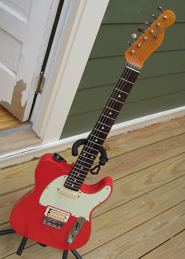

Mages wrote:so I was thinking something like theeessss......
but I decided fuck that noise, I'm going with something more this styley
except I'm doing an open cream bucker in the bridge and a cream duo sonic pickup in the neck.
I know you guys are all doubting me/cursing me now, but trust me it will look ill. you'll see.
third pic is taasttteeeyyy

not sure anyone will care but I figured out what was wrong with the pickups. it wasn't the pickups at all, it was the bridge. you would strum the guitar and could hear that no bass was being produced acoustically. so without realizing it I was basically compensating for this by raising the pickup all the way up. this way it would get some bass response but sound kind of shitty and too gainy. the problem was I'm missing one of the screws for the bridge, so it's not being held to the body snug enough. I just changed the location of one of the screws though and bam, huge difference. I also put on some brass saddles and whoa, they sound much better than the shitty threaded steel saddles. no contest. more bass while still retaining a little top end bite, not all plinky midrange like with the steel saddles. in fact I would definitely recommend this for other fender guitars now, like on musicmasters and duo-sonics.
the switch on there is a strangle switch like on a jag. it pretty much didn't do anything before (should of been a hint something was up but I just thought I fucked up the wiring somehow). but it was because there was no bass to cut. now that I got the guitar making bass I can go from hugely chunky fat riffs to searing snappy lines with the flip of a switch. sounds incredible with the russian big muff.
