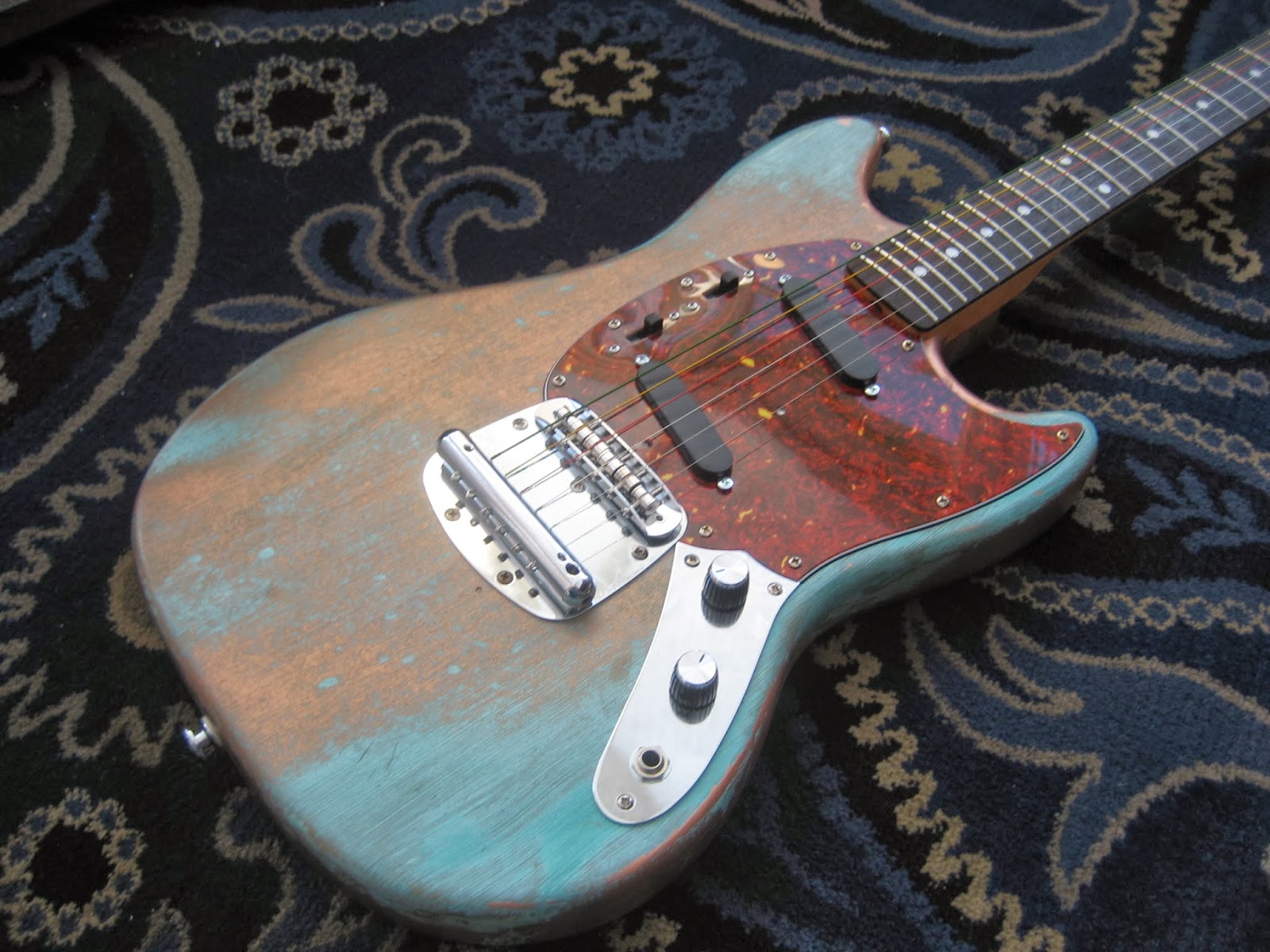

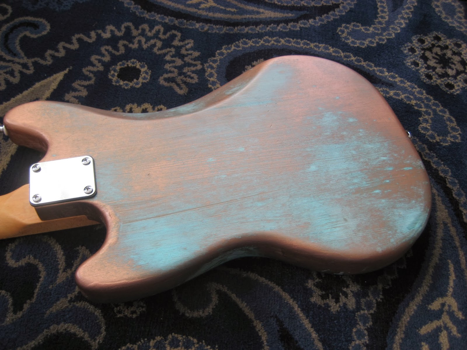

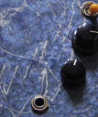

This is my only Mustang style one so far. Two piece swamp ash body, Allparts neck, Mojo pickups and wiring - the finish is the interesting bit as basically I make copper paint using powdered copper, and then start it corroding to the bluey colour with sulphuric acid. The finish is a few layers of wax so over time the copper will carry on corroding, like a slo-mo lavalamp.. The colours are a bit more vivid in reality.

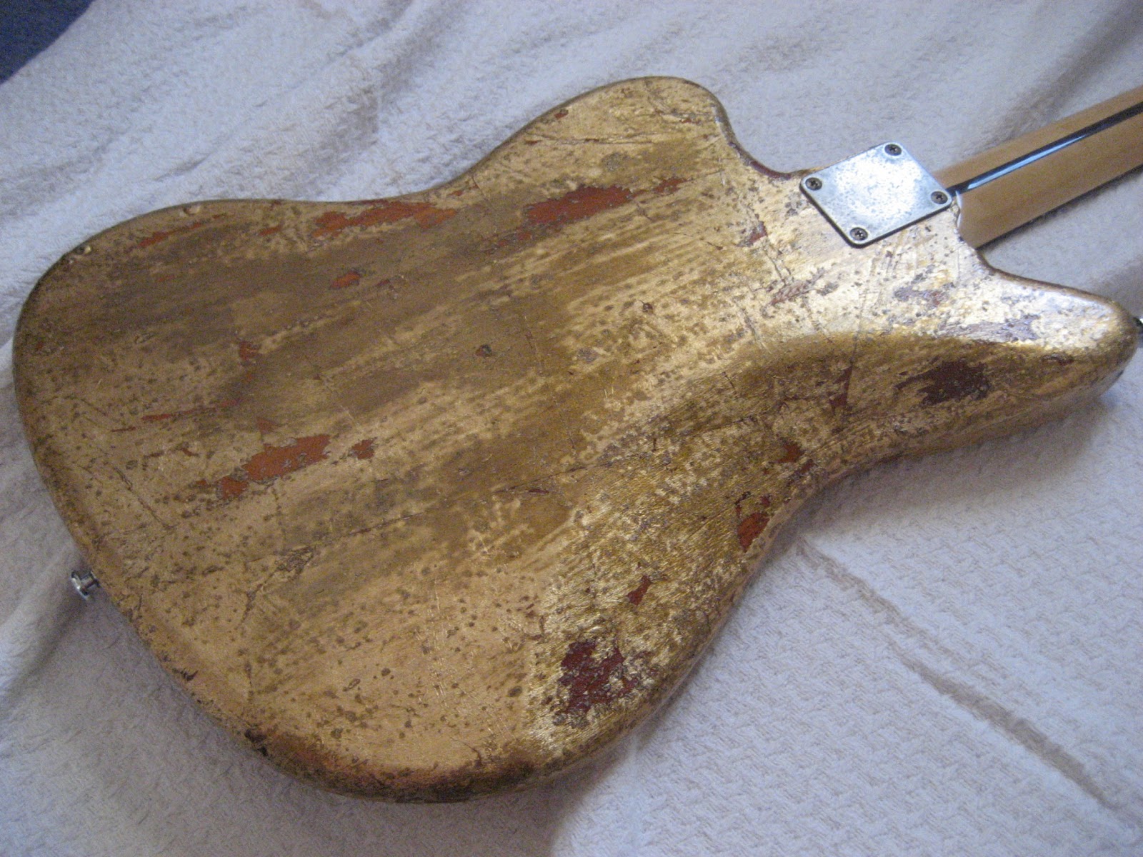

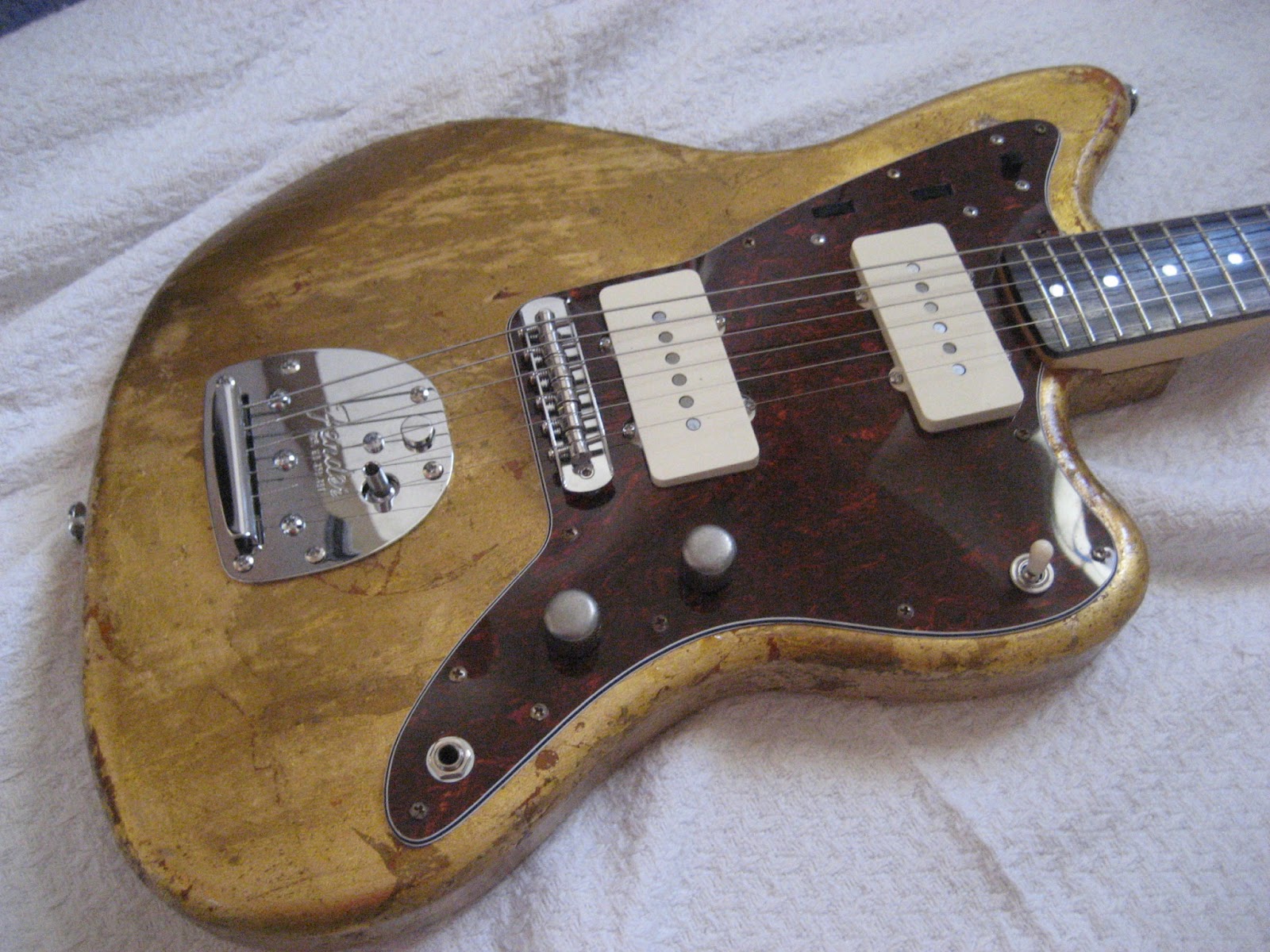

This is stained yellow/red and then covered with 24karat gold leaf, which is distressed to show the stain thru..

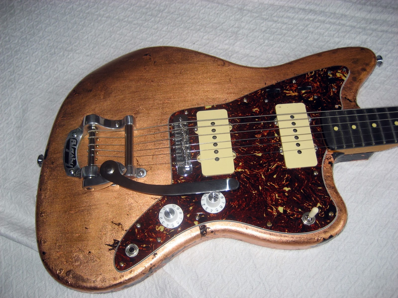

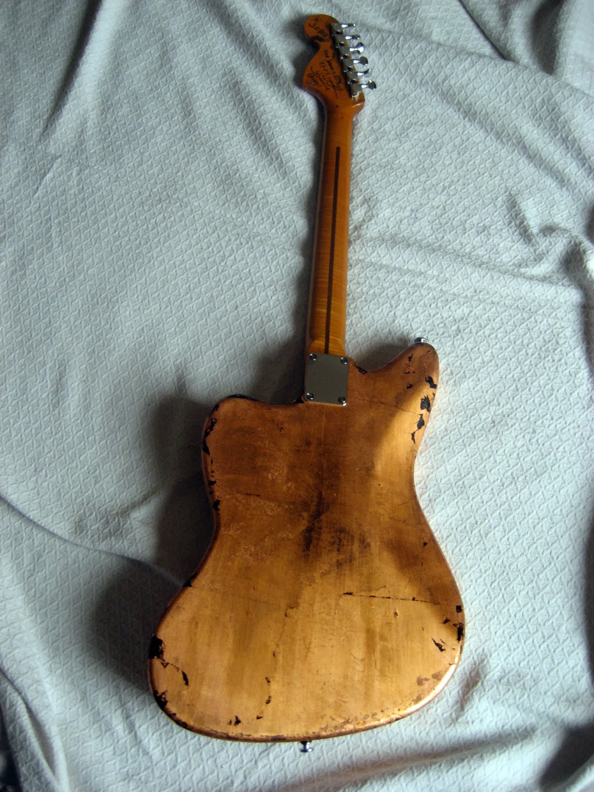

This is similar, but uses a darker stain and copper leaf, obviously a Bigsby B5

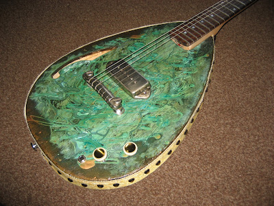

This was a bit weirder - semi teardrop style, with corroded bronze top..

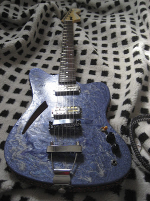

And a kinda skatercaster semi - this is hand painted with dozens of layers of pearl/opalescent paints - took forever, but turned out nice

What's with the neck plate hanging off there? Have you stuck a 25 1/2" scale neck on this body and hoped it'd intonate somehow? Also, why is the pickguard all buckled and wobbly by the switches - is that just the light? The first JM seems to have a wobbly guard too.jookyguitars wrote:
Right, where's me crash helmet...
Also, experimenting with finishes is kinda cool, but you owe it to the buyer to ensure they're at least partially stable and don't fall off the guitar if you look at them funny.

@timhulio Ah, I almost missed it - I was eagerly waiting for the forensic dissection, and there it was all the time. It was well done too - OK the Strat neck was a little silly and spoiled an overall well put together piece (it's always good to leave out what you think is your best line as they always look shoe-horned, don't they?) but overall, much appreciated. If you don't mind though, when you do the Columbo-esque 'Just-one-more-thing' - can you give it a catchy title or something? I'd hate to miss it. Anyway, love your work man...

I gotta admit his pieces aren't to my taste although I would be ALL OVER that mustang. Just the right amount of crazy on that one for me. Really hope he sticks around grand gets involved
