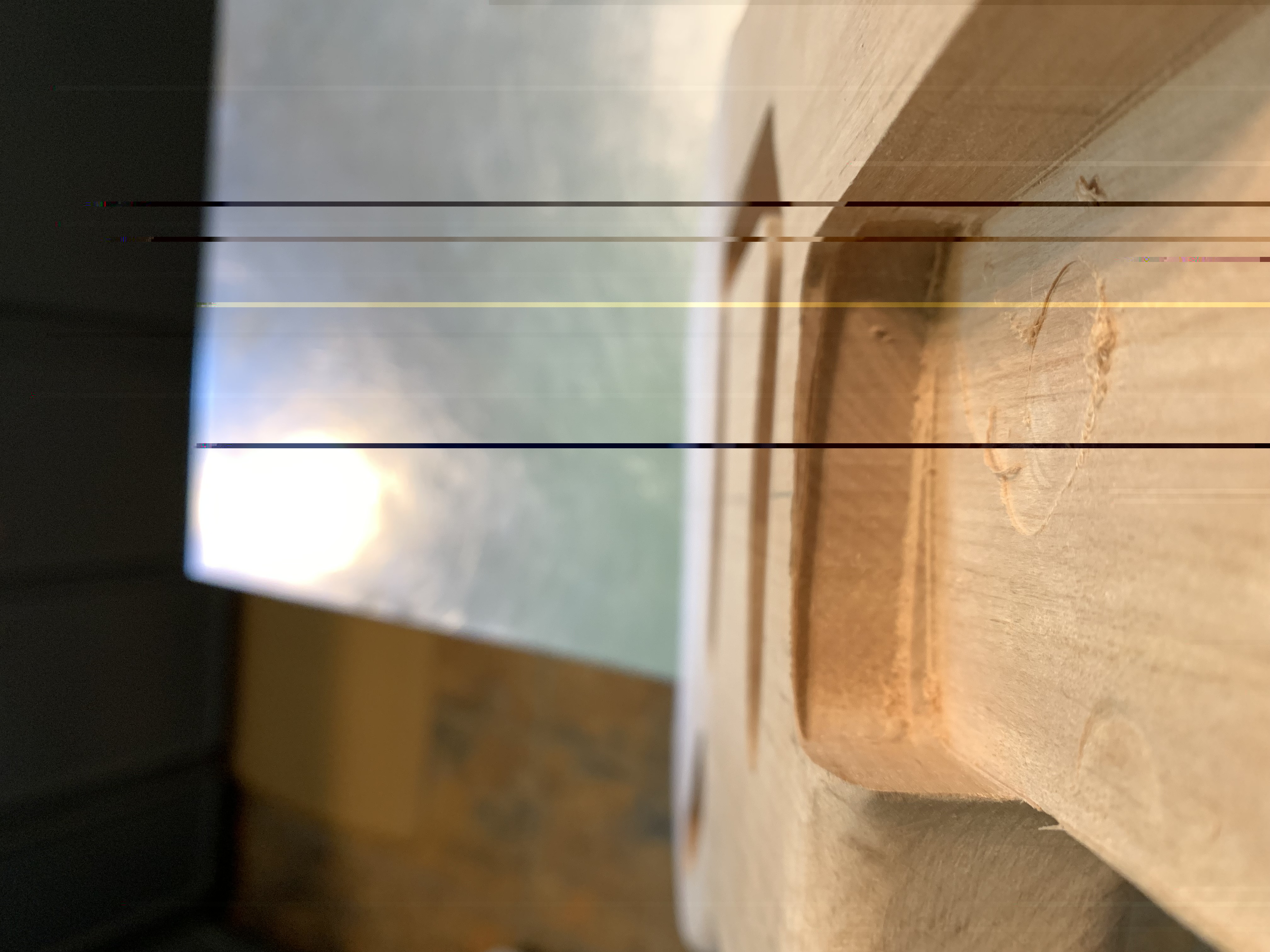

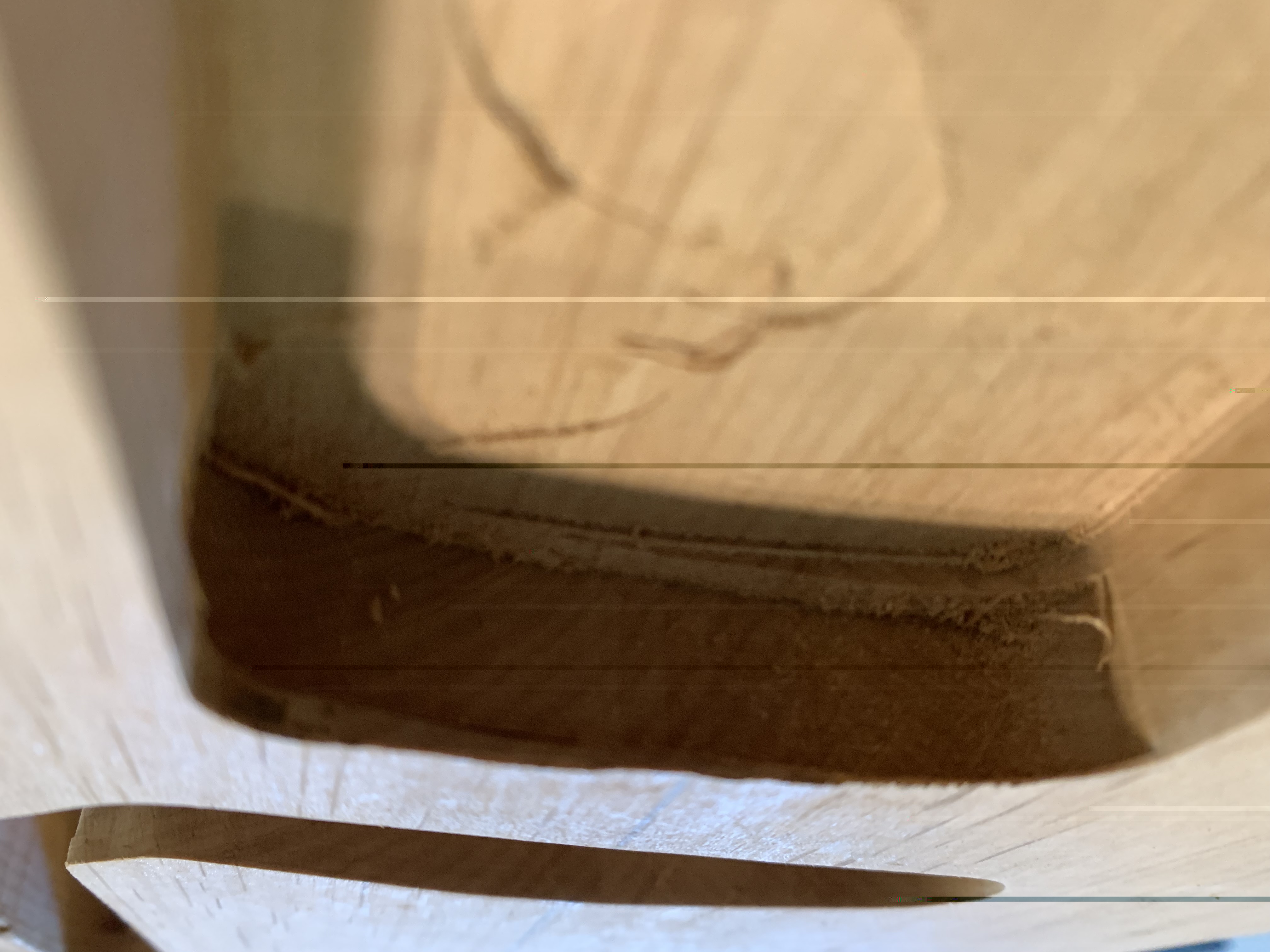

				Welp, just killed it with my router. I was doing some cleanup work on the neck pocket and forgot to secure to router bit bearing…
- IMG_2572.jpeg (1.92 MiB) Viewed 4730 times
- IMG_2573.jpeg (1.67 MiB) Viewed 4730 times
There were other aspects of this build I didn’t love so when I start over I’ll go in with more knowledge than when I started.
I’m determined to pick back up on it over the next couple of weeks. I have three more blanks so, don’t look back I s’pose.

				Good for you for looking at the silver lining
Theoretically you can make a slightly bigger template for the pocket, route it a couple of mm deeper, plug it with a bigger piece and route it again using your original template. It'll be a punk rock geetar, not clean, but ready for a fist fight.
