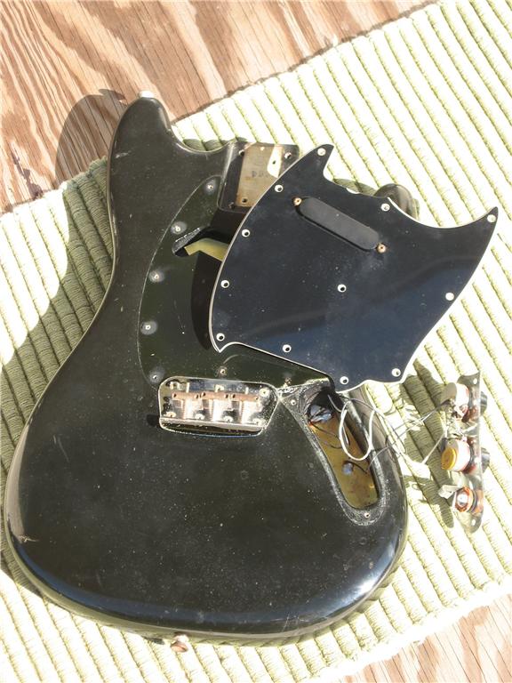

Yummy!! I didn't think that late 70s ones had the Duo routing. Mine didn't Maybe it's an older MM/Duo body, the pickguard screws would seem to point too that too.
yes, I knew someone would point out the body pretty quickly. it's a 60s duo sonic or music master body. it was blue and someone has given it a rattle can refinish job. and then it looks like someone tried to polish it with a dremel. :\ I'm just gonna leave it black but sand and polish it so it looks nice and then put a 78 MM guard on it.
Why not go for the Duo option, 2 pups and all? Duos are one of my fave guitars and the pickguard looks way better. Plus you'll have the screw holes anyway and more importantly the routing on the late 70s MMs are different. The control plate is in a slightly different place. If you go the duo/stang guard option you'll have the chrome control plate which is a big bonus.
The original late 70s MM gaurds are a bit thin/soft and it ended up causing jack problems in mine just from moving around during practice/gigs. I ended up hacking off the place where the control plate would've been on mine, routing it a bit and putting a chrome plate on.
I'm just really into the idea of a simple one pickup guitar. I've ordered a late 70s pickguard in tort. I'll see how it goes. if it's too screwy I may just go with that guard you've offered stewart.
