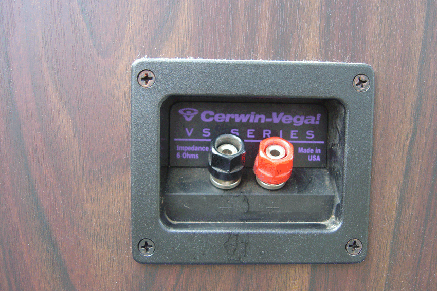

ok i was completely wrong. they don't got the clippy things. they got the screwy things
Posted: Fri Feb 05, 2010 6:19 pm
by robroe
i dont have the thing right in front of me but it seems like i could just take that plate off of there, un-solder the imputs and re-solder them to a simple guitar jack, dremmul out a hole on that plastic thing to screw the guitar jack on. this should be simple. then i can just buy 1/4 to 1/4 speaker cable and not fuck with all these fancy ends an pay out my ass.

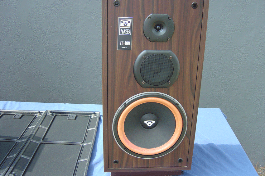

holy shit! one of these things is fucking 300 bucks? what??
http://cgi.ebay.com/NEW-Cerwin-Vega-VE1 ... 58856c5ff0
ok wait 1 is 150 bucks.
fuck i just gave drew 300 dollars worth of speakers...pisssssssssssss

The PCB crossover circuit is bolted to the back of the input panel - you have connections for T(weeter), M(idrange) and W(oofer) on there as well as IN+ and IN-.
That last pair of pics looks like it has combined screw posts and banana (4mm) sockets - with dinky pastic covers for the sockets. The cable you showed earlier looks like jack to 4mm so should be perfect. Otherwise, bare wires into the screw terminals. If these are classic speakers worth good money, don't mess them up.
