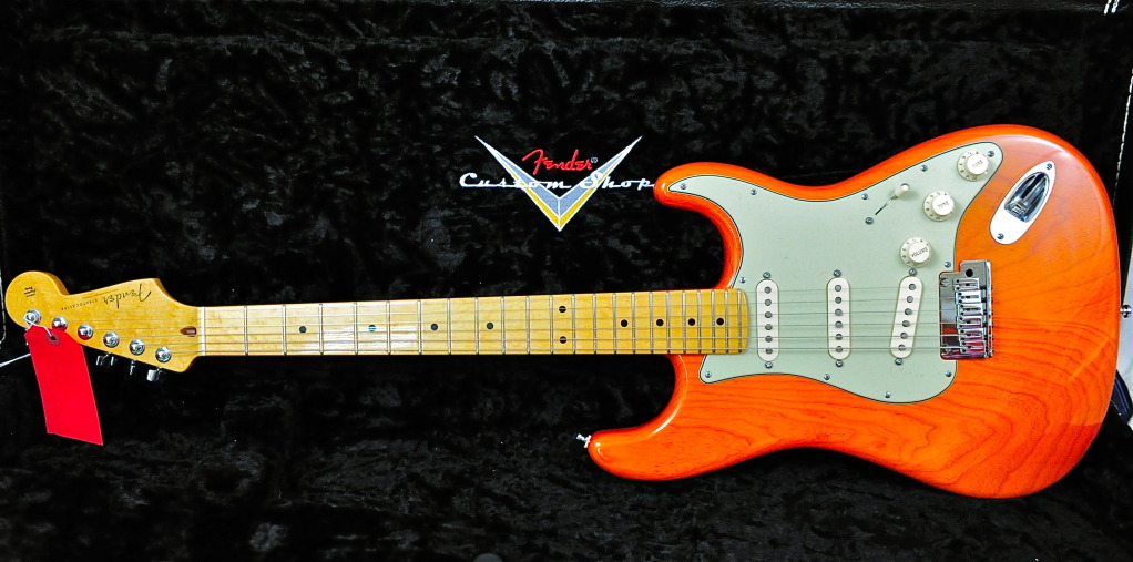

Haha indeed Stewart. Every ding is a memory of sorts. I do keep thinking of using that can of nitro Comp orange on it too...but anyway i'll deal with the neck first methinks!
![Image](http://chrisabraham.com/wp-content/uploads/2010/11/Fender_Custom_Shop_62_Stratocaster_Relic_Capri_Orange_R52579_1.jpg)
