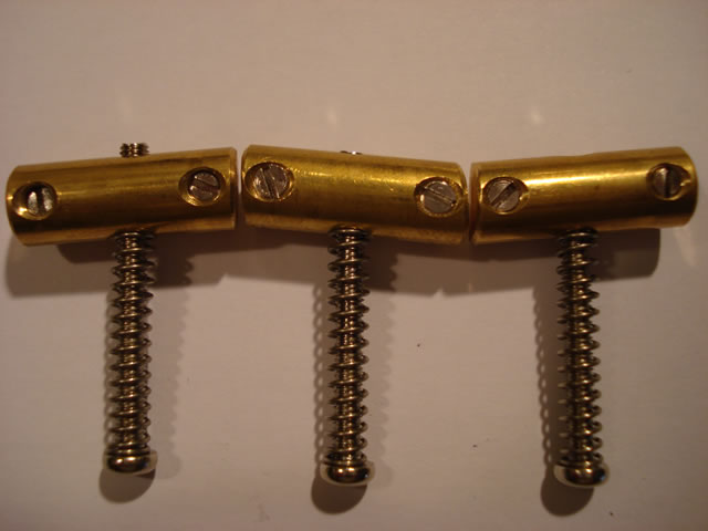

It's had a few parts replaced with... less than optimal replacements. I've been able to source adequate parts, but the biggest annoyance is a a single saddle height adjustment screw replaced with a short wood screw of the same width. Since the Musicmaster (and ime, the 3 saddle vintage Tele bridge) has inherent intonation issues, I'm deciding what to do, so I've come to you in search of advice.
Either A- replace all 3 saddles with wilkinson compensated tele saddles. or B- replace the bridge entirely with a GFS topmount hardtail bridge.
Does anyone here have experience with either of these options?
Thanks

honeyiscool wrote:Saddles rarely have a problem fitting on a bridge.
actually tele saddles do sometimes have an issue fitting on this bridge. I know because I've had problems with it before. I think there are a couple different size adjustment screws that have been used with teles depending on the era. stewart found a set of compensated saddles that fit on this bridge though.

I suppose. If you're willing to drill, though, hehe.Mages wrote:actually tele saddles do sometimes have an issue fitting on this bridge. I know because I've had problems with it before. I think there are a couple different size adjustment screws that have been used with teles depending on the era. stewart found a set of compensated saddles that fit on this bridge though.

Maybe I could solder a very small piece of metal to the ends of the saddles to keep them from moving. I'll figure it out once they've arrived and I can measure them correctly.. Hopefully in early January, once the christmas present rush is done holding up the post office.Johnny Noir wrote:musicmaster saddles are larger than tele. If you put tele saddles, you need to add small things between; if not they gonna move.

An update... right now I'm on vacation sans instrument, but when I return, I'm going to place a drop of solder at the ends of the saddles to try and straighten them out, and install new saddle height adjustment screws to replace the ones it has. I still have the compensated saddles on the way, and I'll try out both options.
