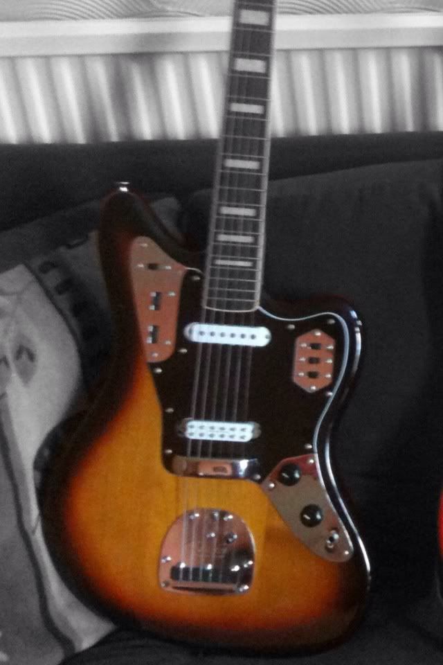

However, I recently shifted from using a mustang bridge to a tunomatic and the overtones are mad... almost making everything sound messy. Also exaggerated by the fact I often use a compressor. Very apparent when palm muting for example. Generally I like I like the improvements but this is the only thing I dislike.
I cut the grooves back in the day when I had it on my Jagstang.... trying to replicate the radius, so they're cut quite deep already.
Before filing the grooves once more, for a third time.... is there a particular way to cut them and with which kind of file ?
I've taped the strings up behind the bridge and that counteracts everything... and I'm happy... but wondered if you had a invisible solution ?
Thought about drummers stuff for heads.... or even recently the mini weights for fishing lines.
Sounds wanky but it's quite noticeable. Can provide video if wanted.

Thanks Doog, I don't want to go for a buzz stop... I've bought one 3 times now and have always sold it on. For me it makes the feel and everything more stringent.
Yeah, was gonna got a hair band solution perhaps. I do think It's due to a badly gut groove... but don'y wanna keep messing and buy new saddles / bridge.
It seems to me the added bonus of sustain and attack has had this adverse effect too.... making the overtones more lively.

I noticed the palm muting issue on my CP Jag with TOM and that's with the trem closer to the bridge. What about putting a strip of foam or some clear algenate type stuff directly behind the saddles on the back lip of the bridge, just high enough to touch the strings? Just a thought, not tried it myself.
If you wanted something snazzy you could go to all the trouble of cloth winding the strings for the a couple of inches from the ball - like the reverse of bass strings. Major hassle though...

Dang I might have just figured a semi invisible solution. Read an old hacking tip for removing audible sound generated by strat trem springs you get some aquarium pipe - the thin clear stuff - cut it to length and slide it inside the springs. So what about some really thin clear aquarium or medical pipe slipped over the strings between trem and bridge - an inch or two might be enough. Not sure if this would make trem action worse or not. /more more thinking out loud
Or maybe coat the with thick nail varnish??

good idea. or you could get heat-shrink sleeving from maplin and do a similar thing.

that's even better idea than the pipe for surestewart wrote:good idea. or you could get heat-shrink sleeving from maplin and do a similar thing.

My Jag-Stang suffers with this problem (Jag trem and humbucker) especially in standard tuning. Its almost like a 'ghost note' effect unless i palm mute.
What i did was reverse the 'Mute' idea. I stuck a strip of draught excluder on the back of the bridge so the strings touch it on their way to the tail piece. Its inconspicuous and it works.
If your not sure what i mean its the foam stuff about 10mm thick you buy on a roll with a sticky back edge for old doors, places like Wilko sell it for a few quid.

Why not try something a little simpler before shrink wrapping, or stringing strings through tubes, etc. Use that clear tubing, or a black foam or something, cut it in a strip and place it on the bridge, behind the saddles over the top of the saddle intonation adjust screws? The strings would lay over the foam/rubber, and that should deaden a lot of the vibration? Make it thin enough and it should be all but invisible to a searching eye.
This is basically your backwards Jag mute idea, but eliminating the new hardware aspect.

Do people actually do this? The overtones from the Jag are the best part of it. Though maybe I'm not understanding what you mean. I get "ghost notes" from both my Supersonic (strat bridge) and my Musicmaster (musicmaster bridge), but not with my Jag, I just get extra sustain on the Jag.
Then again, I also electrical taped the posts on the Jag so maybe that's the extra cushion that is stopping it on mine? I don't get ghost notes on the Jag at all.

Seems odd to be; both my old Jaguar and Jazzmaster did this before modifications, even with the taped bridge posts. Try playing some staccato stuff with a high gain distortion.. no weird ringing sounds between chords?Pens wrote:Do people actually do this? The overtones from the Jag are the best part of it. Though maybe I'm not understanding what you mean. I get "ghost notes" from both my Supersonic (strat bridge) and my Musicmaster (musicmaster bridge), but not with my Jag, I just get extra sustain on the Jag.

I'll have to test this out at home tonight. I do not ever recall any such thing on my Jag, and I've been playing it for a loooooong time, and play staccato often.Doog wrote:Seems odd to be; both my old Jaguar and Jazzmaster did this before modifications, even with the taped bridge posts. Try playing some staccato stuff with a high gain distortion.. no weird ringing sounds between chords?Pens wrote:Do people actually do this? The overtones from the Jag are the best part of it. Though maybe I'm not understanding what you mean. I get "ghost notes" from both my Supersonic (strat bridge) and my Musicmaster (musicmaster bridge), but not with my Jag, I just get extra sustain on the Jag.
I get weird ringing when I play certain strings open (B on MM, G on SS) like an extra note going on, but only when open.

Just get a ponytailer the next time you do a string change. I often keep a small ponytailer on my headstock as well, which is the other source of pinging sounds. I get a pretty loose one so it doesn't kill everything, it just kills enough to avoid annoying me.
Or get a really large ponytailer and wrap it around the whole guitar.
