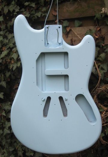

Silenus
Posts: 83
Joined: Thu Apr 01, 2010 8:46 am
Location: Belgium
Post by Silenus »
Primer is done (did 5 layers)
Predrilled the holes so here's how she kinda will look
Maybe gonna go for one of those cream-colored pearl guards and a JB jr
After the holes were done I've sprayed the first layer's of Sonic Blue...
To what grit do I have to wet-sand it down after the last layer of color paint ?
Is 800 enough ?
Thanks

cur
Posts: 7298
Post by cur »
Are you clear coating it?
Silenus
Posts: 83
Location: Belgium
Post by Silenus »
^ Yes, I'm about to start clearcoating it in a few days.
Have 4 layers of color on it now but had to stop after nr.4 due to a few small paintruns.
Gonna leave it to dry for a day and then ligtly sand them off before spraying the last layer of color...
Then preparation (800grit wet-sanding ???) for the clear coat...

So the problem with wet sanding when you have the holes drilled is that the wood will swell up like little pimples when it gets wet. I would probably put a drop or two of super glue or epoxy in the holes to seal the wood first. Wet sand to 800 should be fine if you are going to clear coat. I like to close my eyes and feel the surface for irregularities. Your clear coat base coats should level everything up. Once that is above the surface of the color coat then you can finish that through the grits.
Silenus
Posts: 83
Location: Belgium
Post by Silenus »
Yeah I've been thinking about those holes and the wet-sanding problem (a little late though...)
Think I'm gonna use your tip on lightly glueing the holes and
I'm also gonna try to 'moist-sand' in the aera around the holes instead of really 'wet-sanding'.
Sprayed the last color layer today...so tomorrow gonna start wet-sanding
during my precious spare-time the next days.
Thanks again for al those tips
