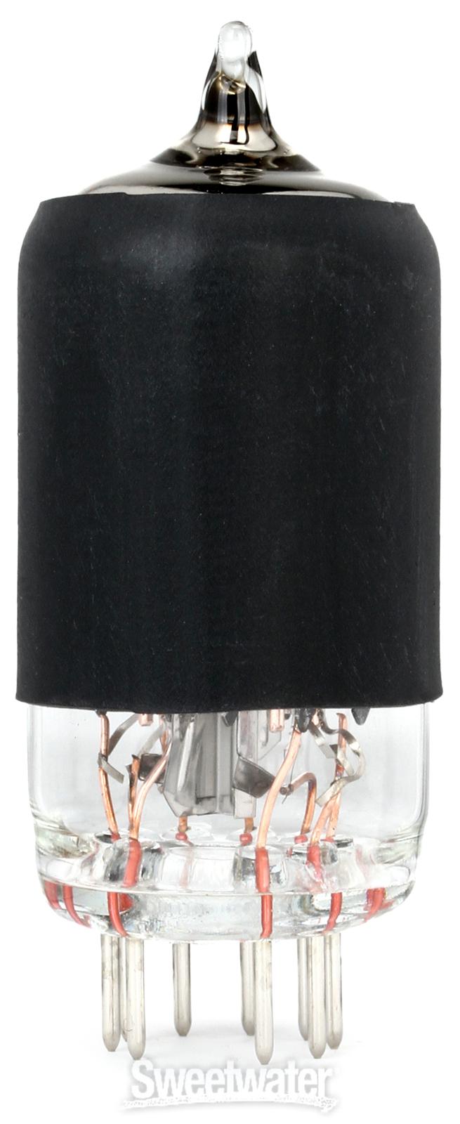

try a mesa spax7
http://www.humbuckermusic.com/mespprgrprtu.html
these are really nice

batsbrew wrote:try a mesa spax7
Looks like they have a heat-shrunk wrapper that stops the glass from ringing?
That looks like an bad idea, if a brand of tubes have a tendency to be microphonic from poor construction, a silicone jacket won't resolve that issue as its caused by internal vibration of the tubes parts! All of the chinese 12ax7's I've had have been shite, maybe get some Sovtek, RFT's or seek out some 80's era Sylvania/GE 12ax7wa with better construction. I would avoid JJ ECC83s or any ruby tube offering and the Groove tubes.

these are hand selected for superior microphonics
read up on them more, that's probably your best bet or another mfg of a similar model.
Posted: Fri May 11, 2012 10:34 pm
by batsbrew
that's a negatory.
that's a negatory.
So what is the function of the jacket?

I think those things are a variation of the aluminium sleeves you sometimes see around valves. Can't imagine they offer much protection, but at least they'd keep the valve more-or-less intact if it cracks or something.

NickS wrote:So what is the function of the jacket?

I reckon it's in loving memoriam of all the tubes that have failed before it.

My guess is it's to prevent Mesa buyers seeing clearly what they get for their money.
