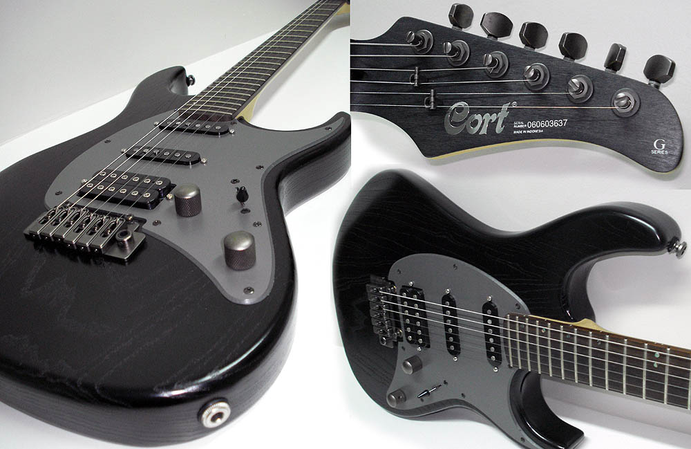

Conclusion first : I'm probably doing something wrong, and have decided to keep the Les Paul.
Exhibit A: Cort G260
This is Korea. Corts are everywhere, and the Indonesian-made ones are especially affordable, the above transparent ash blackie obtained for about $120 and in near-mint shape. The 25.5" scale, sturdy medium-thick "C" neck, and coil taps on the bridge humbucker were the three main reasons I wanted one in particular. My plan was to do a low-tuned AEADGB guitar (and sell my LP7, if it worked), but I didn't take into account a number of variables that made it not work. Here's what happened:
- The Wilkinson 2-point trem is fine, but not for the load I needed, so I had to block it when strung up. No biggie.
- Locking tuners won't fit anything over .60, from what I tried. Had to slightly de-thread the low string to somehow anchor it.
- Used the lower 5 strings from a set of D'adadadareo 11-49s and carefully polished the nut grooves to accomodate the lower three.
- Although it sounded fat and tight with a .70 low string tuned to A (identical to what I use on the LP-7), within 10 minutes the neck began to warp from the bass-side tension.
- Tried to work with the truss rod for a bit, but to no avail. A normal set of strings was immediately put on, saddles adjusted, and it's working better as a "normal" guitar.
- Giving away the guitar to my friend from Costa Rica next week.
This made me rethink the LP7, its massive neck, and how the scale length can better work with a set of fat strings.
In conclusion, I'm eating my words and learning my lesson: I'm going to keep it and get a proper vintage-wound 7-string humbucker for the bridge position and simply learn to play "lighter". It's not all that bad.
