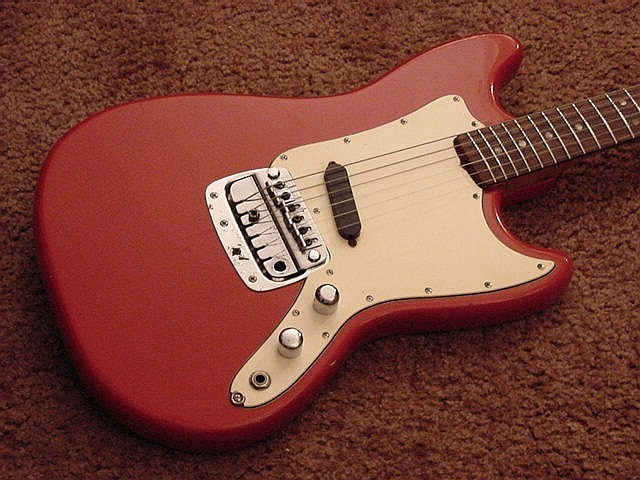

Got a Bronco off eBay. Gave it my 'guitar guy' to make it nice for me. He's taken the bridge/trem apart, and reckons there is severe wear, and some collar missing. Just wanted to check with the experts before I go pointing fingers. See pics HERE
I wish I could see your picture. There are only three things I would call a collar on a Bronco bridge. The arm holder, the bushing below the rear height adjustment screw (so the screw does not turn into the top bridge plate) and the spring retainer that the rear height screw screws to below the lower bridge plate. I havn't looked on the net for pictures. I'm sure there are some around.

So what is not working? If you have all the parts it should work, unless the setup is bad. When I got mine this summer it had a good setup and looks like this :

Again, thanks for all the replies. I think what he was talking about was the trem posts (pivot screw). You can see in this pic that it is extremely worn....
I think it was so worn that it was no longer operating the adjusting the height, and the bridge could. In this next pic, they've been swapped out for a similar style bolt that should now adjust properly.
Anyway, he's now happy that everything is operating as it should. He has an engineer friend who's going to make up a trem bar for it, and I should hopefully have it back in a week or so.
