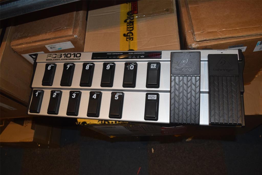

0 (thanks ProgRob) and a Line 6 M5 (thanks Chris). The Behringer FCB1010 looks like a good way of avoiding the tap-dancing that operating the M5 might require and of controlling the Pod 2.0 without buying the Line 6 Floorboard. I got fed up with trying to score one of these on eBay so went to Anderton's and got a second-hand one for £80.
- FCB1010.JPG (76.26 KiB) Viewed 371 times
It's bigger than I thought....
