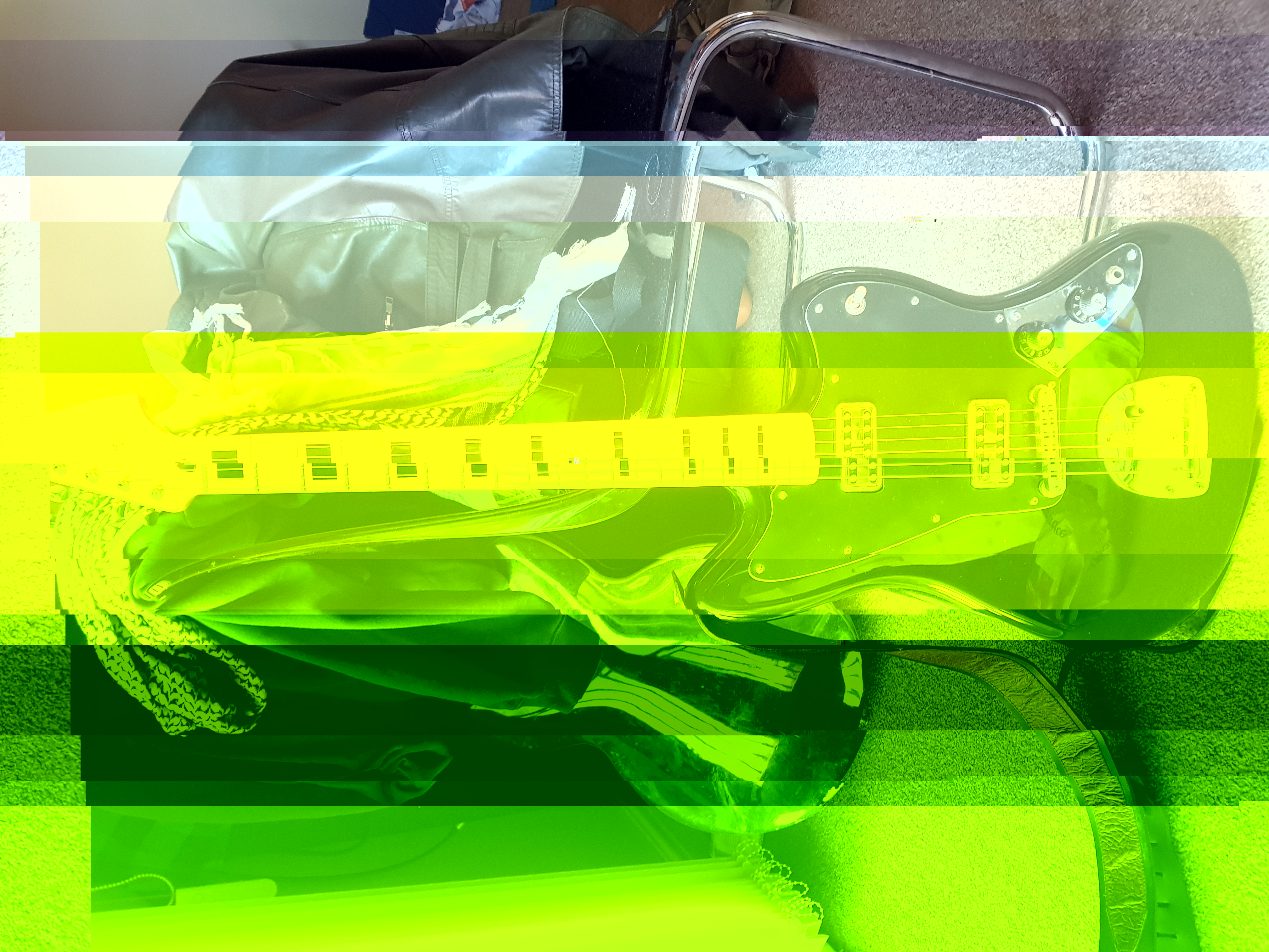

Filtertron'ed Jazzmaster
Posted: Mon Oct 10, 2022 2:01 pm
by ekwatts
I haven't bevelled the scratchplate enough yet, nor have I counter sunk the screw holes enough. But here's where it all currently stands.

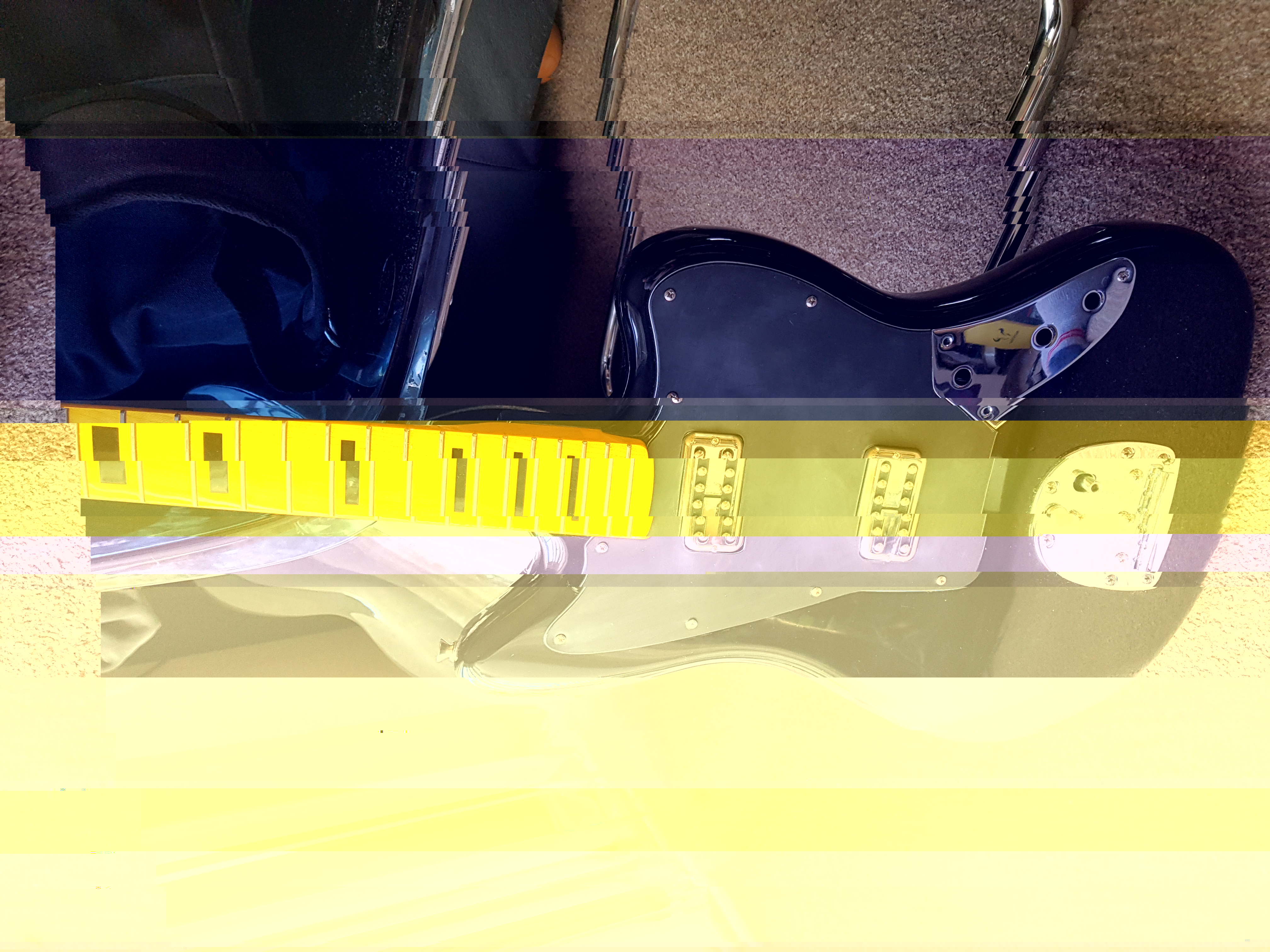

Re: Filtertron'ed Jazzmaster
Posted: Thu Oct 13, 2022 8:36 am
by ekwatts
Finished. I'll try and get a video soon. Maybe.

Thing I still need to do:
Lower those controls. I secured them far too high up, so those knobs are hovering way off the control plate.
Secondly, I can't raise the bridge pickup high enough as the screws are secured into the two little recesses you get on either side of a regular humbucker rout. So I need to fill those recesses a little and maybe even just raise the entire rout by a few millimetres so the pickup has a more useful overall travel distance to and from the strings.
Also, these pickups sound amazing. I've never had a filtertron equipped guitar before (hence why I wanted to modify this one) but I don't actually know if these are "proper" filtertrons, or just PAFs in a filtertron case. They're Roswell Pickups http://roswellpickups.com/product-cate ... kboard_id= and they sure do look the part, and I think I got them at the time because they had the correct measurements, and my intention may have been to replace them at a later date with the genuine article but... er, I don't know if I want to. The difference between these and the stock Fender Atomic humbuckers is night and day.
Posted: Thu Oct 13, 2022 12:29 pm
Surely any piece of material in there would work? A wooden block, an offcut of foam etc?
Posted: Thu Oct 13, 2022 12:32 pm
Looks rad. Your pups are probably the same as GFS ones. In last 10 years they've started making proper budget filtertron copies with ceramic and alnico magnets. By "they", I mean "probably China"
Posted: Thu Oct 13, 2022 12:42 pm
You can use you current screws to attach a narrow plank of wood to the back of the pickup and use the sticking out plank as the ears on a regular humbucker. Then screw through the pickguard into the plank's ears with a pair of screws for height adjustment a la regular humbucker setup. The downside is you'll have two additional screws on your pickguard face and will lose the "clean look". Though companies who make filtertrons usually sell an aluminium plank that is used exactly like that to mount a filtertron like a regular humbucker.

Love it. If you've got a spare mousepad or something just cut that up and make a shim.
