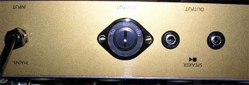

    putting ohm selector right-side up (no comment for now :x )

dad and I overlooked some things since we were working upside down... the biasing stage was gut-wrenching as we discovered major mistakes at that time while risking 500 volts up the fingers. the mains switch was upside down, for one... wrong two legs of the bias pot were bridged, and we'd left out a resistor. it cost us an extra day. and the ohm selector I've kind-of/not-really explained... that was just a silly mistake, we installed it so we could read the numbers, forgetting the chassis was upside down. we had a laugh about it but those wires are so stiff that we can't simply flip it and it'll have to be redone later.
